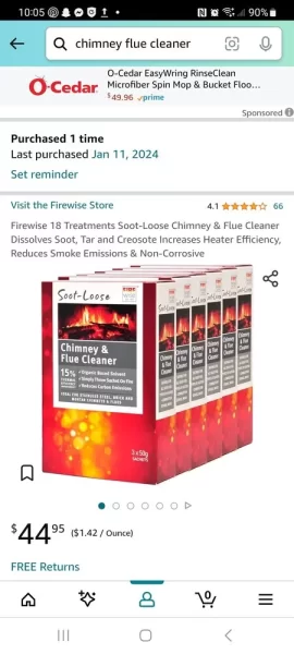

When I purchased my home that had a wood burner, the flu was clean as it could be. They had a pack of flu cleaners behind stove so it made me wonder if they had recently cleaned before moving or were they using these regularly. Any testing been done by you veterans. Opinions?
