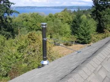

Usually flue pipe braces are rigid. Here's a shot of our stack.

Joe do what BG did...better safe than sorry. 6ft and no brace...that's an accident waiting to happen you gotta lock down that kind of stuff now.

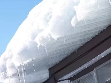

Here is a picture of my roof and the ice overhang last winter. We got 150" of snow last year. I don't think anything but man power can control this amount of pressure on chimney pipe. Shovel after every storm. At least in the vacinity of the metal chimney.

Hopefully BeGreen clicks back on this topic........
Hey BeGreen: in our pic, how do you clean your chimney? What's your method?....being that your cap is way above your roof.
