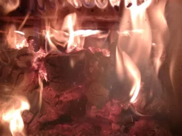

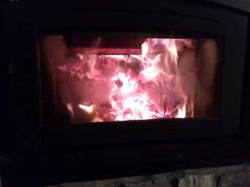

I am getting pretty intense flames at the back of my Pacific Energy FP30. I did some searching and some threads mentioned this is a sign that there is an air leak at the baffle gasket. I don't recall seeing these intense flames earlier in the season. Do I need a new gasket?
Pics aren't great, but I think you can see the steady rolling flames in the back of the baffle. Thanks in advance!

If your baffle hasn't been removed it's highly unlikely anything could've happened to the gasket.
Odds are it's not the gasket. It's more likely that it's now colder outside and draft has increased, intensifying the fire show. Try turning down the air sooner and more aggressively. Before reloading on a hot coal bed, open up the air 50% and let the coal bed burn down more before reloading.
It is normal to have fire in the back, and it is a good thing as well, note that there are some holes in the baffle back there. As for the gasket, it doesn't take match to be displaced a bit by filling the box all the way to the top the wood may slide the baffle sideways and will affect the gasket. In my summit and T6 replace it every season by a home made one, using a stove window glass self adhesive fiberglass gasket.

I had that happen last year. I didn’t worry about it too much, just kept an eye out on temps.
The FP30 is an easy breather so make sure you cut the air back soon enough.

Thanks for the input. I will keep an eye on it.
I am shutting the air down all the way within 10-15 mins. Usually settles in at 600-700. Getting 8-9 hours with plenty of coals to relight on a reload. I love this thing!
