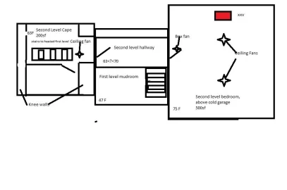

I'm having an issue in heating my upstairs. See attached. (note.. i'd love to heat downstairs with pellet as well.. but baby steps)
What i'm finding is that the room with the pellet stove is getting very warm while across the hall the room is much cooler and, I suspect, still gettign heated the propane heater on the first floor. I've tried using box fans and ceiling fans to help push the air to the colder room, but it is as though the room with the pellet stove wont release its air as much. I have reasoned that adding an OAK will allow air to be added into the room, and therefore force the hot air of the room out to make room for the new air. Is this reasoning correct? I should mention that the middle mudroom first level doesn't exchange air with the first level of the main house. at this point, but it could if it helps. (The loop between stairwells isn't complete )
Are their other suggestions that may help me heat better, especially if it could assist with heating downstairs as well. Anything I can do in the meantime as I look into getting an OAK?

I would try that box fan on the floor facing the stove. Air will circulate better in a circle than trying to force in a wave(everything facing the same way). Hot air rises naturally and will easily follow the escaping cool air. Worth a shot.

Thanks.. I had seen that suggestion in another old thread. I'm definitely trying that tonight... would box fan on floor blowing towards stove and pedestal fan (about 4 ft high) blowing towards the cold room help or hurt?
I had good luck using a box fan blowing cold air out of the cold room toward the stove. I did not have anything blowing the hot air toward the room and it worked very well. I previously tried the pedestal fan as you talked about, but this worked better.

The box fan blowing out should be as low a speed as possible(or it will cool the air) and as high as possible. It will hurt if the speed and air are moved to fast. Like a fan blowing on you in the summer. It will cool it to a degree. Slow and gentle works best/Low cfm fans work the best at moving the air. Not pulling air(box fan on floor pointing to stove pulls the air).
So I should cancel my order for an industrial 3000CFM fan!?!??! :) Thanks to you all for the suggestions. If the Box fan solution works, is this a solution instead of an OAK or will the OAK by itself not solve my issue and still require the Box fan.

Working like a charm, BTW! Thanks so much.

Great news.. This Idea of pushing the cold air towards the stove has not only solved my second floor heating.. An experiment with whole house heating with a stove on the second floor looks promising.
What I did was exactly what you had said with a fan blowing towards the stove. Additionally, I added a fan blowing up the stairs in the mudroom towards and opened the window connecting the main house first floor with mudroom first floor. (Making a loop between the two stair cases) The fan on the stairs seemed to create enough of a draw to pull the warmed air from the second level to the first level via the staircase in the main house.
