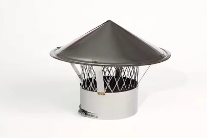

I have a wood burning insert (VC Montpelier) with a 20' liner, and I clean it with a rotary sooteater. I access the liner from the stove and run the sooteater all the way up to the cap. I can see the cap from the ground and it looks fine. Do i need to climb up on the roof to check it? It is a highly pitched roof and pretty high, hoping to hear if folks think running the sooteater all the way up till it touches is fine along with a visual inspection from the ground. Below is a close representation to what the cap looks like. Thanks, Mike

Check it with binoculars. With that coarse mesh screen it's probably fine as long as the wood being burned if fully seasoned.
So when ppl say to inspect it, what are they looking for? The mesh getting clogged with debris? Because I can definitely see that is it is clear, just not really sure what to even look for.
