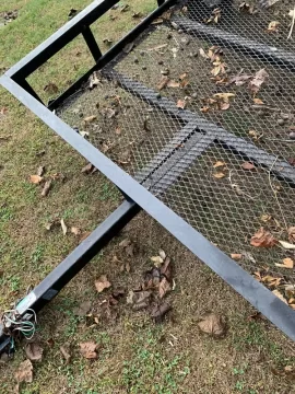

I got 4 by 8 trailer from Tractor Supply. I noted that part that connects the trailer to hitch loose a little where it connects to trailer with two bolts. It's not a lot of movement there, but some.
Is this by design or I need to tighten these bolts or do something else?

they make them like that for shipping, final assembly at the store.
IF it is actually bouncing up and down enough to hit the bolts each direction a lot - it will eventually turn those bolts into halves - I personally would at least take a look at the bolts - support the trailer and pull them - probably one at a time - and see if it is getting wear from it. failure could eventually be a real option. and then you have a loose trailer on adventure that you are liable for. eek! safety chains are up there on the end that would still be attached to your tow vehicle. electrical wires won't hold it close for more than a couple seconds.
the positive side of this design is that if you ever get the tongue bent for you, it is an easy replacement!
since it is light enough to turn over without a crane - I would weld and then of course paint over the repair.
probably have wiring running through the pipe - I would take that out before welding and then put it back. those little guys are worth their weight in gold out here - I know lots of people wishing they had bought one before steel prices went up. looks like a carry-on trailer style - they might be a resource to reach out to and ask.
and if that tongue feels a little flimsy - one could get a tube of the same outer diameter and replace it with heavier, or find a piece to sleeve it. justa thought!
Try to tighten up the bolts and see if that helps. Otherwise they might have drilled the holes a size too big to ensure the bolts would line up.
If you can't tighten it up go up to the next size bolt, say that's 1/2" right now, drill the hole 9/16" instead (ensure the tongue is in the trailer while doing this to guarantee alignment and do it one bolt at a time) then slide in the 9/16" bolt, tighten, and you should be fine.
Other option is to weld it solid.

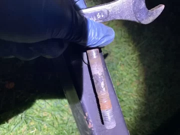

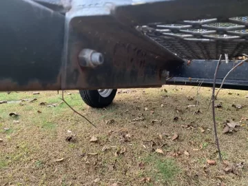

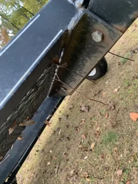

Ok, here is an update.
I unscrewed the tongue and expected bolts. Not much wear on them. I believe it was assembled at the tractor supply by one of their out-of-high school employees. I blame myself for not double-checking . I tightened it up, its 19cm bolts, seem to hold well.
I did not use it that much, just occasional dirt from HD, so not much damage is done to it.

and at this point the holes in the metal are wallowing out. tightening them up will cover the symptom for a while - but I would bet that in 3 loads or less, the tongue will be at an odd angle again. we all know that metal expands and contracts with temperature changes. you cannot keep those bolts tight. part of the problem is the square tube will give as well.
I still maintain Kudos to Dmitry for catching it and being proactive on it. most people never look at things like that until after it "suddenly" breaks.
you could drill those out to 1" and put grade 8 one inch - and it will still wallow those holes. the metal they make those with will just do that with a two bolt design. two vertical and two horizontal with the proper lockwashers/nylocks would be better, but since they ship them to be assembled by store crew - all in the name of profit - is just a bad plan in the long term. lots of people get hurt and killed out there on the highways.
for occasional use and keeping an eye on it - might get by your whole life with it the way it is currently.

If the bolt holes and the bolt are drilled the same size they will last a very long time, movement occurs because it is typical in mass production to oversize the holes a small amount (say 1/16") to allow enough tolerance to ensure the pieces always fit. If the bolt holes are the same diameter as the bolts there is very little movement allowed and there isn't enough force applied in that movement to erode the hole or the bolt. A 1" bolt is unnecessary and will remove material (strength) from the hitch tube.
It is highly likely the steel in that trailer is A36 grade, which is standard for most structural steel. When someone refers to "mild steel" quite often this is the grade referred to. Mills don't make some junk grade of steel just to build trailers with and sell at 10% less.
Adding vertical bolts to the joint won't necessarily fix the problem either, a joint like this is built to allow the shear strength of the bolt to hold the load, but is also designed so that the outside angles on either side of the tongue deflect when tightened to provide a friction joint between the square HSS (tube) and the angles beside it, if this joint is tightened correctly the bolts don't see shear load at all, just tension holding the pieces tight.
