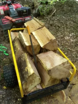

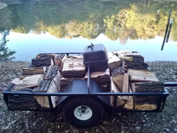

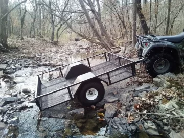

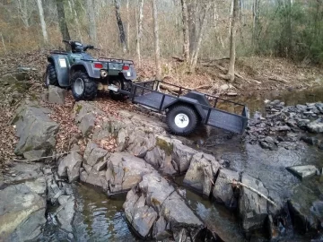

The goal is I have lots of firewood I need to gather from the woods and get to my new wood shed I just built. I will be navigating ATV trails and all and dealing with rough ground and hills. My ATV is a 2000 Honda Rancher 350 4x4, outside rear fender to outside rear fender is roughly 44 1/2 inches. I need to keep the trailer as close to that as I can. Basically I have pretty much narrowed it down to the Polar 1400 mesh trailer with the single axle. Its already 51 inches wide overall. The Tandem is more than that so its out of the picture. Northern tool currently has the 1400 mesh single axle in stock and on sale for $430.00. Comes with the 5 year warranty but who knows how warranty work would really turn out if I needed it. I was about to just go ahead and go bite the bullet and go pick one up when I decided I had not checked craigslist or facebook for anything that might be out there. Turns out there is a guy about 30 mins from me building ATV trailers. The tires sit inside to keep the stance narrower. The specs on this trailer is 4ft x 6ft cargo space but the inboard fenders rob some of that. Overall dimensions are 73 3/4"L x 51"W x 17"H. Total length with tongue and hitch is 101 3/4". A bit log but only 9" over the polar 1400.
It has 22” x 11” x 8” low pressure tires on it. Axle info says 1 ½” square steel tubing with high speed wheel bearings and hubs. Constructed of: .095 x 1” steel tubing with 1” angle upper rails and expanded steel bed. I think everything could be good with it except it just looks kinda flimsy. Wanted yalls opinion on it. He has them listed for $699.00 plus tax. Here are some pictures. Oh for weight rating he just says the tires are rated at 680 pounds combined and could get more weight capacity with different tires and apparently the trailer itself weighs 186 pounds. What do yall think of it? The axle seems it would be beefy and tires ok but the rest just looks real small. But what do I know.
[Hearth.com] ATV Trailer needed, what do you think of this? [Hearth.com] ATV Trailer needed, what do you think of this? [Hearth.com] ATV Trailer needed, what do you think of this? [Hearth.com] ATV Trailer needed, what do you think of this?

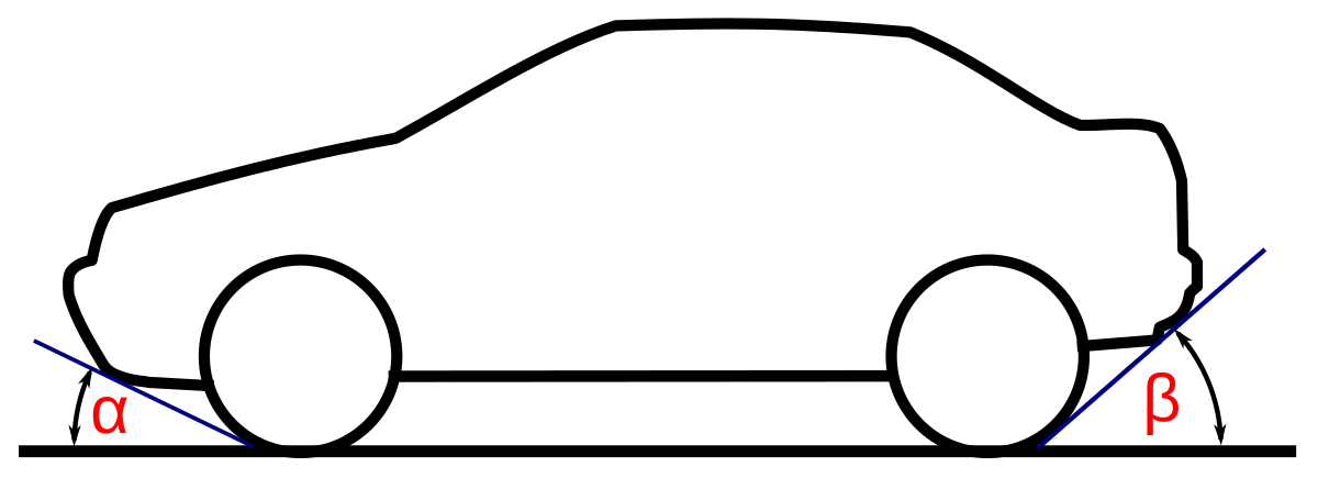

How much ground clearance will that have once it’s loaded up? It looks pretty low now. Low trailers may be fine for yard work, but once you start pulling through what I picture as rough terrain you’ll be digging it in all over the place. The approach angles for the wheels suggest fairly low dips will ground it out when empty. There’s a reason your quad has its wheels pushed all the way to the corners with little overhang.
680lbs max - 180lbs trailer- tires (guessing another 80lbs) is about 400lbs of load capacity. That picture is showing way more than 400lbs of wood in the trailer.
That all might be fine, I’d just want to make sure your expectations match what the trailer will do.

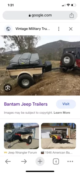

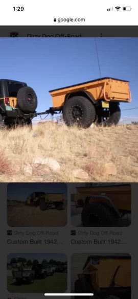

Here are a couple pics of Bantam trailers made for Jeeps in WWII. They show what the Army felt it needed needed for off road trailers rated for 1/4 ton or 500lbs. It’s a fine line raising center of gravity for the load and ground clearance. Width of the axle factors into this too as you don’t want your load tugging you sideways down a hill.

Nope.
Relying on expanded metal for the floor of a bush trailer to carry heavy loads and be impervious to damage from above and below is utterly ridiculous. That wouldn't last me 10 minutes before I damaged it. Well, maybe a week..
not to mention the dust and stuff coming right through your cargo.
nope.
perhaps it would be serviceable with a plywood or board bottom. Lose the expanded metal. Add a little structure for torsional rigidity at the tongue and it might be pretty good.
overall, it appears pretty light duty to me, but there's definitely potential there..
oh, and lose the ball-hitch setup. All you need is a pin hitch. A slightly loose-fitting pin so there's some side-to-side rolling allowed.

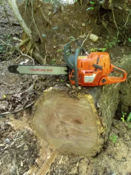

With that said, I got out 4 loads of red oak out today. Trailer did fine so far. 22" bar on the 390 looks a tad weird but she rips. Normally run a 28 but this 22 helping me keep it out of the dirt a bit easier.
