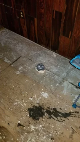

We just purchase a new home and is redoing the floors. I wanted to know if modern fireplaces require an air intake in the floor like my current Avalon 1990 Rainier one or can we seal it up with our new floor and when we replace the stove, we can try to reuse the existing chimney.
For context, the home is built in 1975,1,200 sqft single story and the fireplace is in the living/dining/kitchen area. The current air intake ends in the crawlspace and as for newer fireplaces, we're looking at the (broken link removed to https://morsoe.com/us/indoor/wood-burning-stove/shop/p6140_us).
(First post, so advance apologies if I posted in the wrong section...)
  • [Hearth.com] Do modern stoves need a floor air intake?
Pretty sure you mean outside air intake (OAK) in which case some stoves do some don't. Most will install either way I "think" some installs require an OAK for instance mobile home applications.
