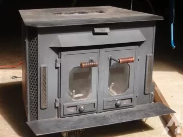

Growing up my family had a buck stove that we used to heat the house in the winters. Some years ago my mother decided to replace it with a pellet stove (and Immediately regretted it). I remember it being below zero outside and having to open the doors because it was just too hot inside. Here's a stove very similar to the one we had.
[Hearth.com] Do they make them like they used to?
You'll notice the large vents on the sides that would blow out air so hot you cant hold your hand in front of it. There's also another vent at the top of the front near the flue control. I've recently bought my first home and would love to get one similar. I've been around many wood stoves since but never seen one that blew as much hot air as that old buck stove. My question is, does any company make them like this anymore?
There are many companies that make very good stoves that crank out great heat yes. But now they make them to get allot more heat out of each piece of wood and put much less dirt into the chimney and the atmosphere. So no no companies make units like that one anymore but that honestly is a good thing.
The Model 91 will broil your hand if you hold it in front of the center vents, not quite as hot from the side vents where the air isn't coming directly over the top of the firebox, above the catalytic combustor. Have you considered weather you want cat or non-cat? Buck also makes some non-cats. Which stove will fit the bill is a question of your home's sq.ft, insulation level and air-sealing, floor plan layout, etc. Also, will the stove be vented into a fireplace or are you running a metal chimney straight up and out through the roof?

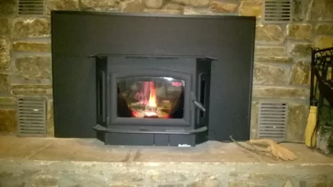

I have a Buck 94NC which is their 91 with burn tubes instead of a cat. It cranks out quite a bit of heat also...we have had to open windows a couple of times.
It requires a little play time than a cat stove but we heat an almost 2200 sq ft ranch style house with it.
I am very pleased with it.
Thanks for the quick replies, I'm interested in a non-cat. We already have a chimney run straight up through the ceiling. The 94NC looks like it might be a good option.
You can set it up as a freestanding stove or as an insert. We have ours set as an insert. We don't get as much radiant heat from it set up this way, but it's all good. To heat the space we do, we would have to run the fan anyway.

It's a nice little stove.
