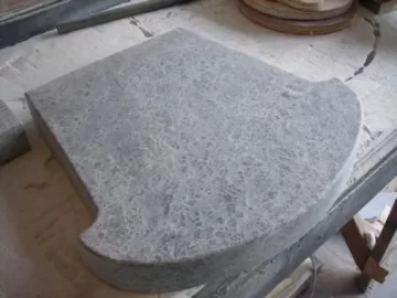

Give us a call. We can cut almost any size square or rectangle, or custom shape (see below) if you can provide a template.
  • [Hearth.com] Do they  make these?
