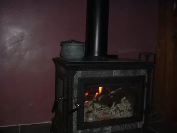

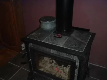

Drat, I'll take a pic. I owe the helpful folks here a pic anyways. When I say kettle I mean a soapstone kettle made by hearthsone which is a bowl of stone plus a cast iron lid that is intended to be used to produce steam atop a stove. It is a piece of art almost and I am not an artsy fartsy guy. A decoration that actually gives a benefit. Some folks install entire woodstoves for just such a purpose.

and Highbeam, I would like to see pics of the "kettle" you have, sounds pretty sweet, whether your artsy or fartsy!

OK folks, here's a soapstone kettle in action. Don't look for a steam plume becasue you won't see one. We only refill every couple of days and there's still an inch or so in there when we do.
