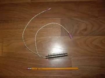

Hey all...
With all the talk on here about Harman igniters being very expensive and what a relatively short lifespan they have, I've been thinking about looking into fabricating my own, just in case. There are places that sell "cartridge heaters" that I think would work and they are about 20% of the cost of a bonafide Harman igniter. I have access to a machine shop if I need to fabricate a mounting flange of some sort. If push comes to shove, I could remove mine and see what it looks like but was hoping someone had one kicking around that I could see what it looks like and save me the aggravation of having to remove mine.
Thanks...
Tim

Here is a photo of the Igniter for the P68.
Unable to attach photo. As soon as I figure how to make file smaller I will atempt to post it.

devildog,
image is there but it's really small. Any chance you could make it bigger?

Tried again

yeah, from what I can make out of the picture, I think it's worth the $95...there ain't no way I'm going to weld all those fins on....I suspect those are cooling fins of some sort?
thanks devildog,
Tim
I would imagine they are "heating" fins to catch more pellets and make starting the stove easier.
BUT , for $30 bucks, I'd buy a cartridge heater and try it just for yuks... might work fine and save you some $$$.
I was told by the service guys at the stove shop that the fins are to more efficiently transfer the heat to start the stove. The incoming air is channeled thru the mounting bracket that holds the ignitor, then into the burn pot. Not sure if a ingitor without those fins would transfer enough heat. I would also be afraid that if I tried some ignitor that was not a perfect match for the stove that I would fry something in the stove and ultimately end up costing me more money the the $50 bucks I saved. JMO
