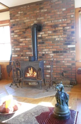

My partner and I live in rural Moosup, CT and are replacing our old Federal Airtight wood stove this year. We have an external brick and tile chimney, and our chimney sweep said our current stove is known to contribute to creosote build-up in external chimneys. Plus, we're pretty tired of getting up 2-3 times a night to fill it. So we've been doing a TON of research (probably over 30 hours at this point) on stoves that would be long-burning, efficient, clean, and not heat us out of our home (the part heated with the wood stove is two floors, less than 1200 sq feet). So far it seems a soapstone stove would fit the bill. We were looking at Hearthstone for a non-cat stove and Woodstock for a cat stove. But then an oddity popped up on our local craigslist, an older non-cat Woodstock Fireview.

I'm so excited to be a member here, it has been an incredible source of information. I'll include a picture of our current stove set up.

ETA: That's a very nice spot for a new Fireview, as Dennis (our resident Fireview aficionado) will attest.
Your hearth setup looks great, no problems there, drop a new stove in and your in bidness!
