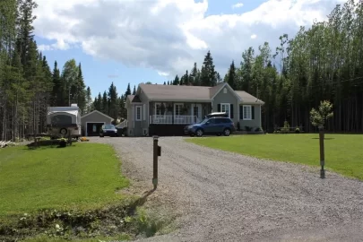

At 4 dollars a gallon for oil , I'm looking at 1000 dollars for one fill, I'll bet I would use at least two tanks over a winter, keeping the farm house as warm as we do with wood. Burning wood I only used a half tank of oil, 125 gallons over a years time. My wood comes right from my property, free except for labor and equipment to harvest it. My stihl is 10 years old, my tractor 12, so a lot of my stuff has already paid for itself. My wood is never going to cost more as oil will just keep going up. Cooking with my wood cook stove saves me from running an electric oven as well, plus heats the house too. Last year I burned about 6 cords. In my soul I'm saving money, a peace of mind, having the ability to be independent and take care of ourselves. Plus I figure harvesting wood gives me good exercise , keeping my health, so it's a win-win situation. Saves me any doctor bills. I think anyone on here who loves to burn wood doesn't really fret over it being cheaper, it's just in ones blood so to speak that it makes you feel good looking at your work, sitting down by the fire and warming your soul, especially if the power just went out:)!
I don't have that much room on my lot for stacking wood...see pic.
I dunno... looks to me like that front yard almost an acre itself, although I understand why you don't want to stack wood right out front. How big is the back yard? I have 7 cords stacked with room to spare in an area only 35' x 35', in 4' wide rows about 6' apart, each 24' to 32' long.
Looks like some already stacked to the left of that camper. perfect place for one.
