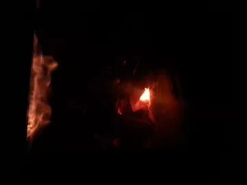

I have noticed my fires running hotter than usual and there is a "blowtorch" like flame coming from the same spot every load. I have checked the ash dump and that is secure. Could I have popped a weld or something? Also noticed I have to tighten the door down a little harder than I use to to get a seal. Here's a picture.

What kind of stove? cast iron plates? welded steel box? can't discern much from that photo. I see the bright jet of flame, but it's not clear what part of the stove it is coming from. Check your gaskets and the fit of the door(s). Is there an ash pan? Sometimes ash or dead coals can get packed in behind the pan, making the ash door hard to seal.
It's hard to make out what we're looking at. Any way to post a video? Is that blow torch like flame coming from around the door? Could just be a gasket failing. What kind of stove are you burning in? (It can be helpful when included in your signature)
Steel englander madison. I did have a problem withthe ash dump accidentally dislodgeing, this flame isn't over the dump though. The flame is coMing from the bottom of the box. The picture is rotated. Secondaries are on the left, bottom of the box on the right
Check the gasket. Sometimes I get flames in one spot form time to time but it's only wood offgasing. If it in the same spot all the time I say you might have a leak.
Gasket around the door? Ill check it. And the flame has been in the same spot for 3 fires

Unfortunately all I had were 100$ bills, went through a couple but oh well... heres a short video. Im watching it now and it is burning way more vigorous than previous fires with the same amount of wood. It's concentrating on the right side of the box which also has never happened before.

That fire does indeed display a good measure of vigor. Perhaps a little vim as well. Too much vigor to spot the exceedingly vigorous flame that precipitated this thread. Did you snug up that door already?

This is without adjusting the door. I just pulles the ashpan and held a lighter to the ash dump and it "sucked" in. Is this normal? If i uses aome fireplace mortar on the plug would that take that out of play? I'll let this die out and adjust it, hopefully before tonight.
