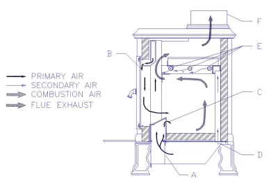

BTW here is the airflow of the Manny....

As a side note... from personal experience on the Mansfield, closing the primary most definately does shut down dog house air. Just so you know.
I saw that in the pic you left. Always interesting to see how different manufacturers make different use of what may appear to be a similar device.
