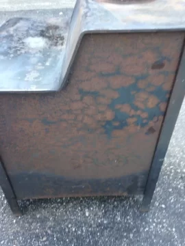

I broke down Sunday and picked up a neglected Grandma Bear that was on Craigslist for a little while. It's nothing special, just a black door model with angle iron corners and doors are stamped "80" with aluminum draft caps. The former owner was a bartering bandit and never ran this stove, it's was just sitting in his garage amongst other trading stock. Gotta give the guy credit, He did not budge on price much and I could only bring him down $10.00 and it was a rainy Sunday, perfect day to talk someone down at least $50.00.
So I got the stove home and it's not too bad at all. Mostly surface rust and what I believe to be Stove Polish. Whatever is on the top, it's thick and will come off with a wire wheel and the orbital sander is the best tool so far. The sides are really easy to bring down to just steel, the top is another story. I keep opening up pitted areas that kinda remind me of the Sargent Castilo from Miami Vice, that's how I see it.
There's no problem getting the rust off, whats a good way to smooth it out?
I may just send this stove to another owner and profit off my elbow grease after cleaning it up and giving a new CUSTOM paint job, thinking a Mahogany Metallic or Sand stove body with Black Fisher & pine trees on doors. Problem is I am already getting attached to it and might give my Isle Royale the winter off to try a real deal old school steel stove.
Using the stove like we did for years using the top for cooking and a humidifier kettle required a sanding and repainting the top each year. I was contemplating a quick coat of stove black when it was at its coolest to keep it looking good all winter. I'm glad I decided against it. Stove polish is almost impossible to remove. I've wire wheeled, sanded and wiped with mineral spirits and even lacquer thinner. Warmed it up and wipe and a rag still comes up black. Since you only need to remove it from the top, you can try a propane torch like you're removing paint. It is not a super high heat coating. It removes much easier from smooth steel than rough cast iron which it is for. Polish also allows water right through and is the main reason why paint is much better. Once you're convinced you have as much removed as possible, I like to use brush-able paint first and let it thicken in a small open container. Then apply it to the top with a plastic auto body filler spreader. Even a piece of stiff cardboard. It will fill the holes easily, allow to dry and lightly sand with a finish sander until as flat as possible before painting. After 2 coats and firing you shouldn't be able to see any signs of the pitting.

Thanks for the information. I am making good progress with my wire brushes and am able to get the pits pretty well smoothed enough with some effort. In one of your earlier posts you did mention it goes fast, you are correct. The simplicity of the Fisher is pretty impressive.

This is how it looked when I started tonight, will post the progress tomorrow.
Here she is after a little more brushing. This is going well. I have a Hilti drill but, would rather a polisher angle grinder type device like Coaly is seen using.

Yeah, that's an antique all aluminum Black and Decker grinder / polisher. Low RPM but a knotted wheel is the most aggressive and cleans large flat areas quick.

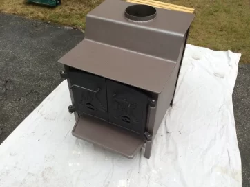

I finished my project and was able to season my paint yesterday, it was very fun.

Looks great! I like the Brown with black door scheme.
I'm considering using a propane burner without the firebricks inside to season the paint. Anyone ever tried curing paint that way?
