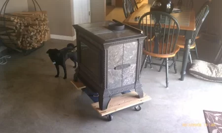

I moved mine from the pallet in the bed of my F350, up one step and onto the hearth by myself. Moving big things takes a little bit of brawn but a whole lot of thought. A furniture dolly and scrap lumber is all I needed. Did it again this summer when I rebuilt the hearth. Lifted the stove 10" in the air all alone. Go slow and don't smash your hootus.
I did have a buddy come over and help with the shop stove since it was way up on an 18" hearth. We did it wheelbarrow style.

  • [Hearth.com] Doing "Self" install of blaze king ashford 30.1
