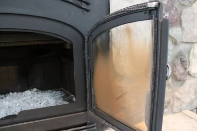

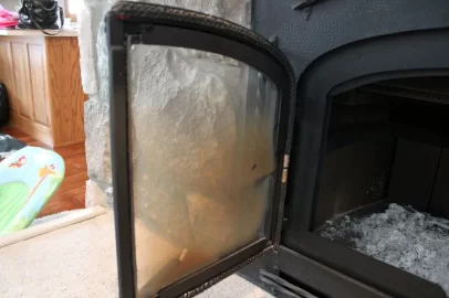

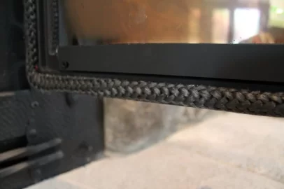

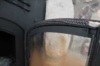

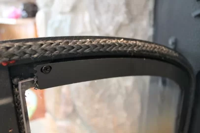

Here are some pics. What do you think?
[Hearth.com] Dollar bill check... [Hearth.com] Dollar bill check... [Hearth.com] Dollar bill check...
I do think that there is some air infiltrating at the gasket seam. Pretty noticable in first picture. I think a little sealer would take care of that.

Looks like the higher density rope to me. What is puzzling, is the gap between the vertical gasket & the door top gasket? What seals it between the two? Looks like a good 1"+ gap between the two with no gasket?

Ya the pictures posted do not show a good shot of the vertical gasket for the center seal. It wraps around the front. That actually seals quite well. Scotty has a Nepolean.
Like I said, the hundred dollar bill is snug but can be pulled out. I will call the fireplace store I purchased from and ask them. Scotty's issue was the center where the doors come together. I have no concerns there but still am mildly questioning the seal around the hinges. When you buy a new unit and put out the money, I tend to get picky.

the looks of your glass, I don't see anything that would indicate a leak. It does look like you have the dense gasket, so snug is all your going to need. Too tight will cause other issues. By all means check with the shop, and see what they say.
