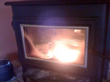

I love my 13, Lowes Summer Heat, Englander..But I can also turn my door handle 360. It has a sweet spot??...problem???
If I can turn the door latch 360, do I have problem?
Since I didn't burn last night, the house was a cool 54 °F this morning and everybody was cranky.
I called ESW and got some advice similar to what Pen posted. I added a small piece of pipe on the inner door latch. Problem solved. House is nice and warm.

I started a thread about the same thing as far as a leaking gasket in a stove (nc-13) I purchased in Jan 2010. You could clearly see on the glass where the air is coming from and I know I was burning plenty hot enough. After reading this I looked at my lever and found it to out of "square" and bent it back with pens method, no problem, but didn't fix it.
I will be replacing the gasket shortly and the place where the two ends meet I'm gonna notch them in a way that they fit together with out an end to end fit, to rid myself of any potential gaps.

pen said:
when I first bought my 30 the handle would do a similar maneuver and my glass was turning dark in spots no matter how I burned. Next time the stove got hot I opened the door, took a piece of 1 in steel pipe I had around and put it on the inside part of the door latch, put some weight on it to bend it to make the door tighter (really not that much) and have never had a problem since.
Not saying you should have to do this since you obviously have a new stove, but it's what it took for me. Best I can figure my door handle bar was about 1/8 in out too far. It didn't take much to get things tight.
The picture in my avatar is before I did this maneuver. Now, my handle is pointing directly at 4pm.
Good luck.
pen
The handle on my 13 will also go 360, and it dont take much muscle.
How long was your pipe, I have tried bending mine with a pipe wrench and it hasnt made any difference.
And I should trying to bend it back towards the door, correct?
Thank you for any advice..
Pipe is about 2 1/2 feet long. I simply put gloves on, held the outer handle / door for support (get a helper w/ ove gloves on if you can even) and then the other hand on the pipe which was on the inner latch. Basically, just get leverage on that bad boy but support it.
Again, you shouldn't have to do this on a new stove. I did it because my stove is used. Defiantly call ESW.
pen

Well, w/ the door open, I am actually bending the round-stock latch out, so that when closed, it will push against the metal wedge in the stove harder.
If you are looking for a metal pipe, look in your closet. I've got black metal pipes for hanger rods. Or if you have a floor jack in the garage, a handle from one of those will work.
