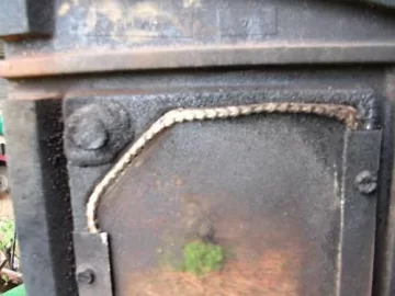

This is glass wrapped the way you want it.
[Hearth.com] Door sealing Gasket for Fisher fireplace insert
This is flat gasket not protecting back side of glass.
