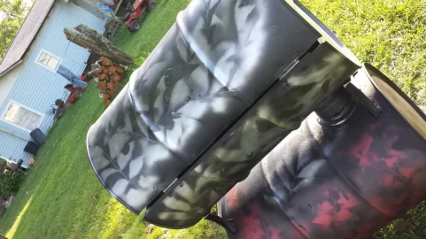

Wow I really want to see this thing. Try copy/pasting just the url without the IMG or URL tags. We should be able to click on those no problem.
Here's what I have
  • [Hearth.com] Double barrel wood stove DIY plans?
I would be putting a setup like this into my barn. I too hate salamanders with a passion.
