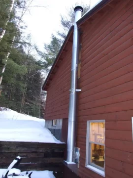

Try Home Depot. That's where I purchased my entire Class A chimney for my shop furnace (exterior install). Spent about $750 total. The place I bought my Oslo from quoted me over $1500...just for the parts. I'm all for local business support...but not at more than double the cost of elsewhere.

  • [Hearth.com] Double wall dhimney at Lowes?
