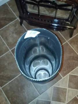

1. The telescopic stove pipe looks like it was squished during shipment. Any ideas on how to reshape it?

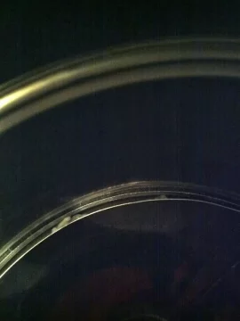

2. I needed a 15 degree offset kit. I loose fit it together and noticed that the inner lining didn't fit snuggly and I could see some of the insulation. It isn't much but is this ok with the flue gases basically getting into the insulation space? The picture I took isn't very good but hopefully you understand what I am describing.

Take it back to the box store and have them order you a new one. They can charge it back to the shipper. Did you notice the damage at the store and then except it or did they not inspect it before you brought it home?
Thanks for the advice so far. I assume both of you are referring to the disformed telescopic double wall stove pipe. What about the elbow kit? I have attached another picture that better shows the male end that points down to the stove and how it appears smaller than the female end. I understand that it should be smaller so it fits inside the female end but I can see some of the insulation when I look up it. Is this normal?

Why don't you give Selkirk a call and ask them if it's normal.

That elbow is normal. After everything is secured together there will no issue.
The double wall needs to go back. A telescoping section is useless if its dented, with the dent it won't slip worth a darn.
I'd return it and get some pipe from a hearth store. It could be snowing in 3 more weeks!
Good to hear about the elbow.
The double wall telescopic stove pipe slides easily and I think I'll be able to reshape it close to a perfect circle. The end was squashed not dented.
