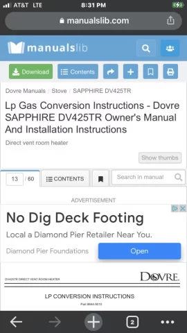

Hey All, I know this has been asked in previous thread in 2019, I have exhausted most of the redirections to the different parts house that may have had the original conversion kits for the Dovre 425 and other models, but I am not convinced that there is not another conversion or cross reference to these obsolete models? the original NG to LP conversion kit was 844-0400. What came with the kit? Did the burner/plate have to be replaced, or was it just the burner and pilot orifices as well as the regulator diaphragm? I have used the unit about 20 times in twenty plus years of ownership, and was thinking of converting to LP just in case S.H.T.F.
Can I plug burner orifice and re-drill? What changes have to be made to pilot orifice? My regulator is a Robertshaw-Grayson 7000 series NG and I believe I can replace the NG with LP diaphragm? Am I off target for wanting to convert, and why is it so hard to find info on doing so?
Vendors willing to sell me brand new unit for$$$$$, which I don't need to spend, just want more options to keep me alive should such a need arise. A wood burning stove is not an option for me, hence the quest. Thanks in advance to those willing to answer or reply.
