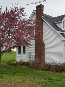

I've been reading allot about downdrafts and negative pressure. I have a super 27 that I brought from my old house. It was used on the main floor and never had any trouble with it.
Our new home has an exterior masonry chimney with clay liner going to the basement. The house is a two story with the chimney on the east side of the home which goes 4-5 feet above the peak of the roof. Since hooking it up I have noticed I have to run the air intake about half open to get any heat out of it. I also have noticed there is a substantial downdrafts when not in use. I have to leave the basement door cracked to get the fire going and if I close it anytime prior to a decent fire it'll smoke back through the dvl pipe.The furnace is about ten feet to the right of it and is a geothermal unit.
I contacted the company i purchased muy stove from and they thought an outside combustion hose would need to be used to solve it. I agree it might solve the combustion part but would it benefit me from having the smoky smell in the basement? I guess I'm asking if it would solve the downdraft when not in use?
Any help would be appreciated. I'd really like to use the stove as supplemental but that smell is being circulated through the whole house.
