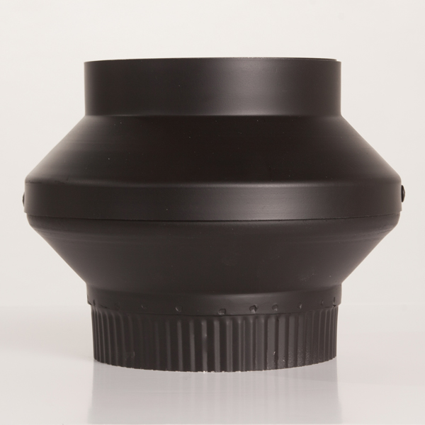

Try this instead:
Reactions: GENECOP
Try this instead:
I read about that, it probably works well, but the $400 caused me to hesitate...
