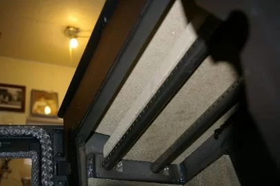

Hello all! This is my first post. Just purchased an Englander 17-VL. It was installed two days ago and I'm really having trouble getting a fire started. The only way it seems I can get it started is to leave the door cracked to create a better draft. Needless to say, I get smoke in my home. If I close the door tight before about 10-15 minutes, the fire immediately goes out. Once the fire is roaring, I can close the door and it will stay lit. I have the damper per se open (pushed all the way in). The stove is on the main floor and has 6 inch duravent double wall pipe to the ceiling where I go to triple wall out through the roof. There is two 45 degree bends in the pipe to get around a ceiling joist. Total run length is about 16 feet. The chimney is about three feet above the ridge of my home. Does anyone have any ideas?
![[Hearth.com] Draft issues Englander 17-vl [Hearth.com] Draft issues Englander 17-vl](https://www.hearth.com/talk/data/attachments/168/168767-7ad0af791707183fdda7187331553159.jpg?hash=Z-9spoOevH)
