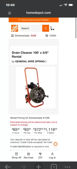

I rented one from Home Depot once. Kind of hard to beat their price, and they get to store/maintain it.
