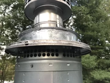

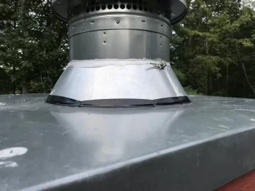

Recently, a 6 inch stainless liner was installed in a ZC double wall 10 inch chimney flue. The reason that this was done was for a fireplace insert install. Now, when it rains there is a very noticeable echoing of raindrops from the chimney chase in the house. As far as I know there is not water intrusion into the chase. There is a metal chase cap and a 6 inch chimney cap. (please see the images)
The original chimney cap was removed when the new 6 inch liner and cap was installed. The base of the original 10 inch liner was left in place. I never had a rain noise problem before with the original chimney design, but now there is.
Any fix suggestions?

Was the tape at the base always there? That would be the first place I would check for leaks.
The tape was removed. This was an earlier unsuccessful troubleshooting attempt to stop any dripping noise.

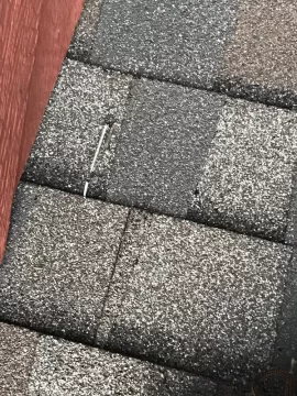

The top image below (i hope) is a screw that was imbedded by one of the guppies (inexperienced installer) in a shingle.

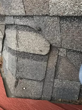

The bottom image (i hope) is a short raised ridge in the roof about 12 inches long running to the front of the chase and back towards the peak of the roof.
You can see a roofing nail, cracked shingles (4 years old!) and two 16p nail heads.
I think that this entire area needs to be ripped out and replaced with new shingles ( I have 2 1/2 bundles left over from other roof work on this home.)

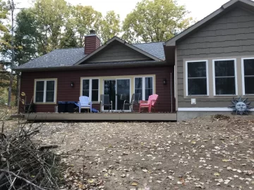

The old cap, as I remember, was flat on top. (Please see image below)
The image below was captured when I first moved in. The previous owner had not put in a lawn.
