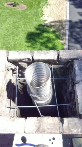

Helped my neighbor over the summer with his drolet insert install, really happy how it came out.
He removed clays, bottom ones he used a sledge hammer taped to a broom handle!
Insulated light wall liner, ss top plate
IMG_2351.jpg IMG_20170909_125927.jpg IMG_20170909_130444.jpg IMG_20170909_134104.jpg
Prefitted liner so we could mock up blockoff.
Block off plate installed, made an oval hole so we could attach liner far back then pull into place. Siliconed 2 pieces of sheet metal in place to cover ovel hole.
