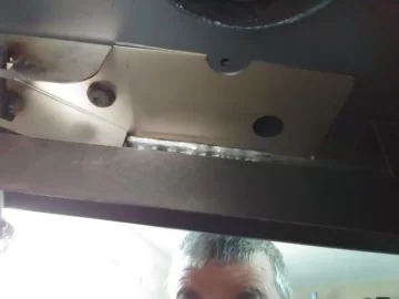

Can I get a definition of 'dog house holes' and 'dog house air'. I have seen the term 'booster air' and now 'dog house'. Are these the same thing?
I have three holes that enter the firebox at the center front of the stove. There is a hump centered left to right in the firebox. The three holes enter the firebox from that hump. There is a single small hole beneath the hump that is covered by the primary air slide unless the primary air control is full closed. That small hole feeds the three holes from the hump.
Is this the doghouse and is it also referred to as the boost air?
[Hearth.com] Drolet 1800i  operating temps? [Hearth.com] Drolet 1800i  operating temps?
Yes doghouse and boost air are the center air holes. Same thing. They provide primary combustion air. My air control never completely covers the air intake because of the round hole in the slider.
