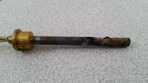

Hi there. Any help would be appreciated. Bought a new Drolet Eco 65 last year. This is my first heating season using it. The second time the unit started up, the original igniter quit working. Called SBI, and they sent out a revision kit for a new igniter system-apparently their original igniter system was having problems. OK, not a big deal. That replacement igniter got me through until Christmas when it blew a fuse and wouldn't light. Called 12/36/14 and SBI sent me out another replacement igniter. They said they couldn't understand why I went through another one, but thought maybe I just "got a bad one". When I took it out, it had a hole burned completely through the outer metal wall. Well, today after doing my weekly ash emptying and vacuuming, it would not relight, and the igniter fuse blew. Is anyone else having ongoing igniter issues with their Eco 65? If so what have they done for you, and how have you corrected the problem? This is getting ridiculous for a stove this expensive.

[Hearth.com] Drolet Eco 65 Igniter problems It is the new style igniter, hole is approx. 1 cm diameter and 2 cm from from tip.

hyfire is right. It's staying on way to long. I've watched mine ignite a few times (same stove) and I'm almost 100% positive the ignitor itself isn't on very long. That would be a control board issue Inwould think. But, you also said they sent you a new board and the same thing is happening. ...
I just shut mine down for the weekly cleaning and I'll clean the glass real good and watch when I restart and see just how long mine stays on.
