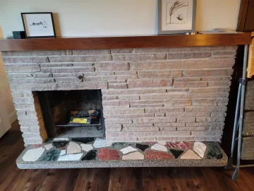

And here is our current masonry fireplace.
For esthetic and code purposes, would it look weird if the insert is placed at floor level? I like the idea of raising it, but not quite sure how to go about that? Build brick hearth with some kind of stone or polished concrete for the finish? Weld a metal frame for the insert to sit on then construct hearth from brick/concrete? Or leave it at floor level and make the hearth wider? This picture of a polished concrete hearth for inspiration.
I think I would like to raise the insert off the floor about 4" and add a raised hearth. As per installation instructions, if the hearth is level with combustible floor, the hearth must be 22" minimum from the insert. If it's raised 4" from floor, then it only has to be 18". Currently, the marble hearth slab is 17.5" and the insert will stick out from the facing a few inches, making the hearth even smaller.
The current fireplace opening is 25"high. The insert is 21.25" so even if I wanted to, without demo-ing the current fireplace opening a bit, I can't raise the insert a full 4".
The mantle is definitely too close as well. Drolet says no less than 27" to any combustible materials above the fireplace at any depth, so I'll be looking to redo the entire mantle, pushing it higher.

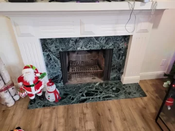

Also, separate to this fireplace, we have another fireplace that needs a bit of a facelift. It's in a small room and won't be used to any capacity, but would like to "modernize" it to some degree. Any suggestions?

I don’t think floor level looks weird. The issue is making the hearth 2x” extension with R value. There are lots of examples on here. If I were to do it I would make it flush with the floor like the current one. I don’t care for the concrete look but if you were to go the route removing the lintel and replacing it a bigger job than I would care to take on. I could see going the polished route doing it flush to the floor. Just to make the job easier. The trim/mantle probably is going be removed? Check to see if you can reduce mantle clearance with a heat shield.
Second fireplace. Is that hearth extension floating? I really dig that if it is. Probably would figure out how to refinish/surface hearth extension. New mantle. I’m not a fan of painting stone but it’s an option. Probably would go all the way and paint mortar lines different color than stone.

It is indeed a floating hearth extension. Keeping it, just trying to figure out how to refinish it. I'd like to whitewash the brick I think.
Researching what type of product to use to bond tiles to the smooth marble, but definitely a project for much further down the road.

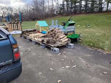

Got my woodshed started the other day. This will be storing wood I plan to burn in 1 years time. It will be a mix of various softwoods, a bit of maple and apple from trees on our property that are dead or dying. Probably wouldn't seek out softwood normally, but where the trees have to come down anyway, might as well put them up the chimney as free heat.

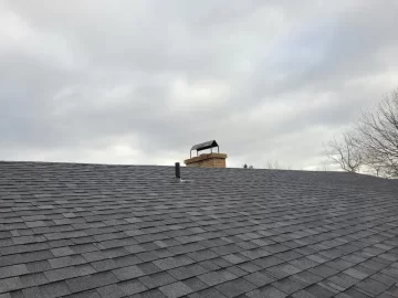

For the chimney liner/cap situation. There are 3 flues exiting the same chimney (two fireplaces and an oil furnace that is no longer in use). Sorry for poor photo, scared of heights and thought I had a better way onto my roof.
My plan is to make/have made a chimney cap that goes over the whole chimney, similar to this:
Is there anything wrong for the time being on installing the liner with just the top plate and no cap other than the one that's already there?

As long as it keeps the rain out I think it would be ok. I might think about a screen to keep kritters out if you/someone is up there. My problem with the time being is that it could be two years it I get back to it. If someone is up there just do what needs to be done for the long term while you are working on it.

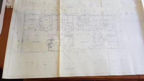

This is our basement layout.
We have 2500sqft on one level, plus 2500sqft of basement, half of which is finished. So far the temp on the main level has been a consistent 70 degrees, which we're happy with, although sometimes find a bit chilly. The bedrooms are at one end of the house, and we've found the two bedrooms at the very end of the ductwork stay quite cool, partially due to the ductwork, partially due to old windows in those two rooms and partially due to fact they are west facing and don't get much sunlight through the day.
The basement probably stays low-mid 60's, which is ok for now as the kids are little and aren't down there a ton.

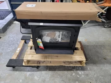

I think I've made up my mind that I want an Englander 28-3500 to supplement our HP. Missed out on this one by a few weeks, although a bit rough looking.

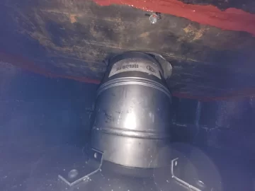

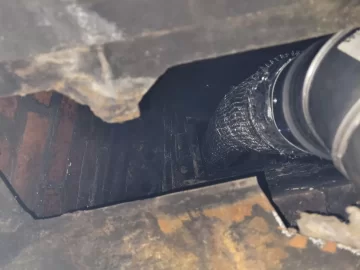

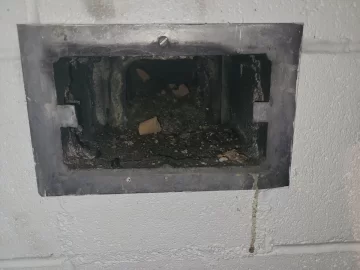

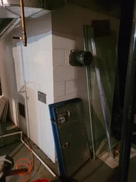

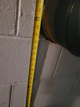

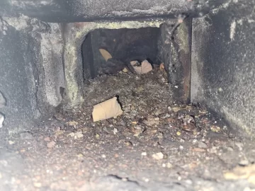

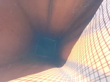

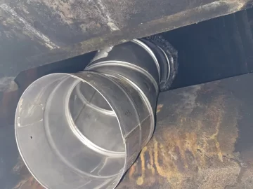

As I'm uninstalling the old oil furnace, I'm looking at things and wondering how to go about installing a liner.
This will more than likely be something I hire out as I want to make absolutely certain it's done correctly, but any ideas/suggestions on flue setup?
There is a 6"x9" cleanout on a side adjacent to where the thimble will be. It is roughly 21" from the bottom of the cleanout to the bottom of the thimble opening.
Also, I poked around the bottom of the cleanout (it badly needs cleaned) and there doesn't seem to be a bottom to it right off. How does one accumulate this much junk burning oil???
Will I need a bigger cleanout installed more towards floor level?
What supports the liner if installed with the stainless cleanout not sitting or supported on anything? Does it just hang in the flue, supported by the thimble 't'?

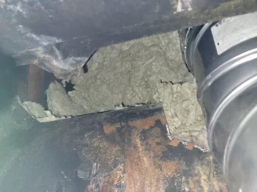

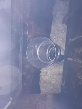

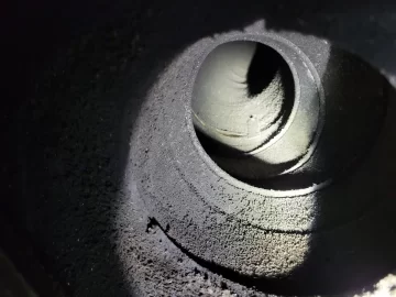

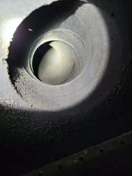

Got the cleanout cleaned out today. Still not sure how a person can accumulate so much junk burning oil. But it's gone now.
Got a better measurement. Inside of flue liner is barely 6"x9". Is it even possible to put a 6" round liner in, or am I going to have to put an oval liner in?

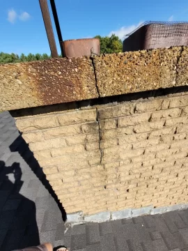

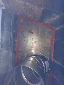

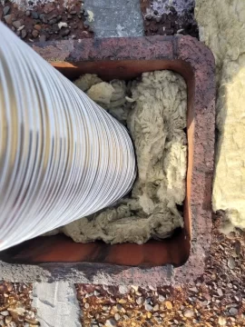

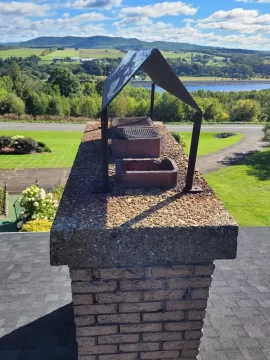

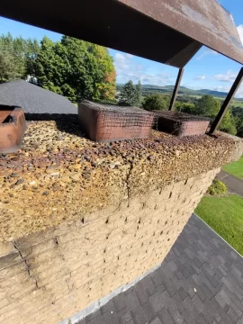

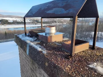

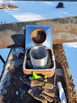

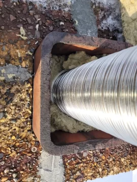

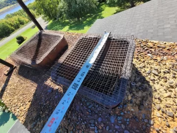

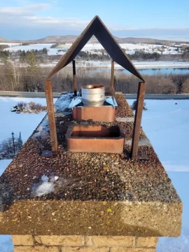

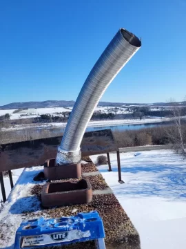

Finally got up on the roof to have a look at the condition up top.
Couple cracks in the crown and brick, so I'm going to fill those with quikrete and seal with CHIMNEYRX crown repair.
My plan is to build a custom rain cap that fits over the entire crown which should hopefully help with weathering. That won't happen this year but hopefully next.

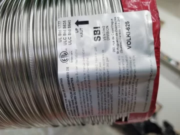

Wood stove insert runs up the centre 12"x12" chimney, lots of room for an insulated 6" liner, measures about 16' from top to throat of firebox.

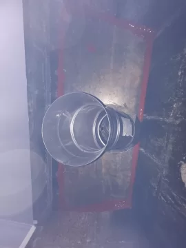

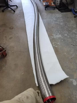

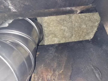

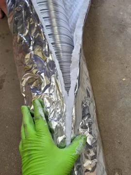

With the help of my FIL, we finally made the time to install the liner and insert. It's not 100% complete but just a few finishing touches left.
I still need to tuck some ceramic insulation between liner and block off plate, install fire brick and mantel heat shield, then ready for first fire!

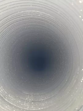

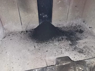

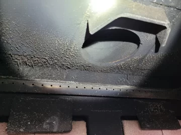

First fire Nov 28. Burning smaller fires once in morning and again in evening, not every day. 15' insulated & lined chimney. Some seasoned pine, some standing dead pine cut and split last month that's definitely under seasoned.
Thoughts? Advice?
I know I need to get it hotter faster, and 2 small fires makes more creosote than keeping it hot all day, but still getting used to this! 20221221_124353.jpg 20221221_115513.jpg 20221221_115526.jpg 20221221_115551.jpg

I know I need to get it hotter faster, and 2 small fires makes more creosote than keeping it hot all day, but still getting used to this! View attachment 305783 View attachment 305784 View attachment 305785 View attachment 305786
Is it fluffy?

I think it looks good. My pine gets the black fluffy sooty stuff too. Mine’s not creosote. Sounds like to know what you need to do and are doing it. Keep it up. If you’re not lighting top down that the one tip I could offer.
