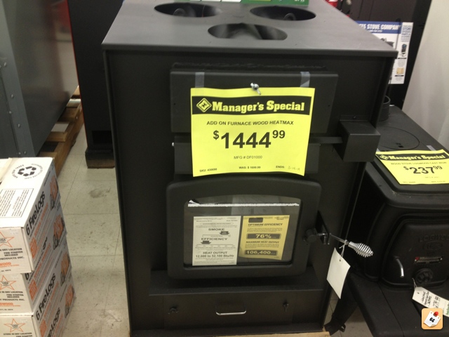

Just thought I'd throw this sale I just saw out there for everyone to see.
[Hearth.com] Drolet HeatMax Review/Install
Cheapest I've heard of yet! Wherezat?
