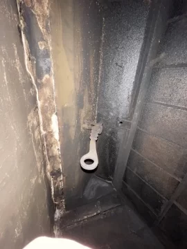

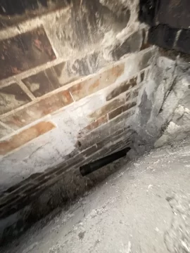

Post a picture of your damper mechanism. The plate is removable in most of them
Here is my damper system
  • [Hearth.com] Dropped Vacuum extension tube cleaning smoke shelf
Pull the cotter pin out of the handle and lift the damper plate up. It takes a little twisting usually but those are typically pretty easy to remove
Thanks I was going to attempt that but I was scared I would drop that down in there too how far down is a smoke shelf usually?
It is usually flat with the damper frame. But some poorly built ones drop way down.

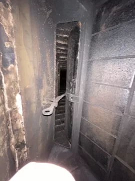

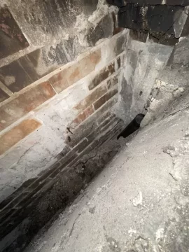

With the damper removed, take a picture of the smoke shelf area with flash to locate the extension. That will determine the plan of action. Don't drop your phone!
Reactions: Osage
I lifted the bottom of the damper and I think mine drops down quite a bit. If that is the case do you have any advice?
You will be able to reach down pretty far with the damper plate out
So the camera ideas was great. I was able to see where the tube was and used a sweep pole to raise it straight up and down then was able to reach it. My shelf is differently not level with the damper and goes all the way down. Thanks for the tips to help me out this is why I love forums.
