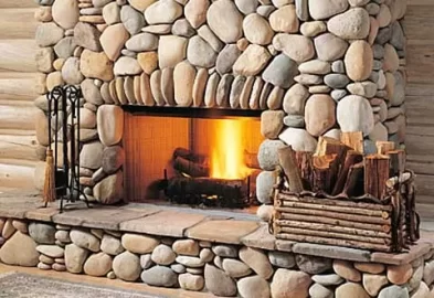

No advice on application, but being an old house nut owning many old stone houses, I can give you advice on design. Most of the cultured stone applications I see (many on this forum) are simply horrendous. It can be done well, but so few take the time to look at what a real stacked stone fireplace really looks like, before jumping into the nuts and bolts of how to stick it together.
For starters, stone should never, never, NEVER look like this:
[Hearth.com] Dry stack cultured stone
The mason (or homeowner) who built that has clearly never taken the time to look at a real stone wall, or they'd realize stone is never laid up on the edge like that, excepting perhaps down the center of an end wall containing an interior chimney.

Oh... just noticed I left the round rock photo attached to my OP. Not intended, but I was looking at that as an example of exactly what Highbeam says... different materials can lead to different design. In answering the OP, I was assuming a more traditional field stone dry stack.
