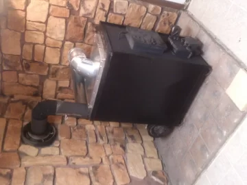

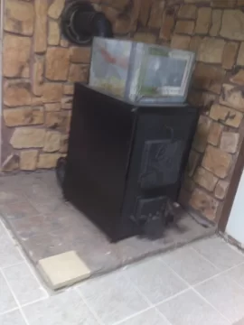

[Hearth.com] duct work??? [Hearth.com] duct work??? OK I bought a older wood furnace And for the duct work it had a Plenum on the top with a spot to hook up to my existing duct work in my home.... my insurance company says that the plenum is wrong and canceled my policy because I apparently altered the stove. So since I received my cancellation notice I have changed it up a little to see if they would decide not to cancel my insurance does this seem right to you guys? I will add pics the one with the plenum is a before shot and the one without it is a picture of my alternative.

The duct goes straight through that back wall into a room where my gas furnace is and hooks into my furnaces duct work to blow throughout my home
Yeah, that single duct looks WAY too small! Or need several more of them.

I thought so myself I was debating on adding one more on... it is a six inch duct coming out of the top now
I think the smallest I have seen is (2) 8" ducts. Depending on the BTU rating of the furnace, it may need a good bit more than that. (1) 6" is definitely not enough
My wood furnace has a 16" round off of the top feeding back into my propane furnace. That setup is way too small.
My Yukon has 24x24 plenum, (2) 8x24 ducts coming of that. That will flow a lot of air! Your 16" round is almost 200 sq in., his single 6" is only 27! fire hazard city!
Well it had the single 12" round duct hook up so would two 6" be good? Because furnaces at menards of a similar size out of the two they had there one had a single 12" hole out the top and one had two 6"

On the bottom of the back side of the furnace there are two fans mounted there so that would be the return

Do the math, (1) 12" is around 108 sq in. (2) 6" is only 54 sq inches! Also, you have to compare actual BTU rating, firebox size, and CFM of the duct blower, the Menards furnace with (2) 6" holes likely was a lot smaller furnace

And this is more seat of the pants than anything - but looking at that pic, with the way the duct immediately goes down, that looks like a heat trap that could cause some very serious grief if there were a power outage or blower malfunction while there was a wood fire burning.

Oh yeah, I see it now! I thought that the duct just went to the right through the wall, I didn't see the second ninety and the downhill run through the back wall. They would consider that a downdraft install. Yup, no insurance co. will take that, heck, the don't even let you do downdraft fossil fuel furnaces unless it is made/certified that way. Darn shame too, cause your new "plenum" ductwork shur is purty!
