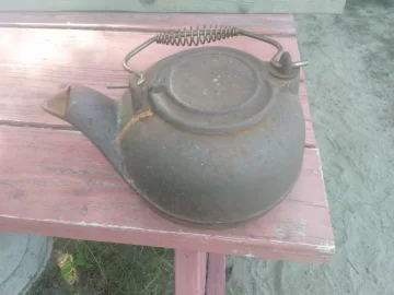

I had to make a dump run a couple weeks ago. One of the things that fell into the truck before I left was a cast iron tea pot! Woo hoo! Treasure!
It looks like it's been full of water for a long time, like decades. How do I treat this thing? It's easy enough to scrub the rust out, but are the insides of these things seasoned like a pan? I wouldn't think so, but figured I'd ask.
I prefer cast iron cookware but really can't find a use for a cast tea pot. The problem is that they rust quick when you put water in them. A good coating of cooking oil will make it look good but you wouldn't want to use it for tea after that.

Just remember that cast iron is very porous compared to other metals. If it's decade old and been in a dump I would be hesitant to use it for anything other than decoration.

Yeah, I get that:) That's part of the reason I just don't see the use in them. They leave a rust ring on the stove. The inside of the pot just stays nasty and they really don't do anything for humidity levels anyway. Basically just a non functioning replica of a tea pot imo.

Electrolysis. Get a plastic 5 gal bucket of water, dump in 1/3 cup of Arm and Hammer washing soda, grab a scrap of iron (eg rebar) for sacrificial anode, set item and rebar in water, but not touching. Connect negative lead of 10A battery charger to item, and positive lead to rebar. Make all positive voltage connections above the water line, or it will eat your positive wire.
This process works line of sight between rebar and item being cleaned, so use multiple sacrificial anodes if you want process to go quicker, and your charger capacity is sufficient.
Figure 3 days to clean all old paint and rust from most items.

I was always using this process on much more expensive items, so never even thought of the cost, but it amounts to about 2 kWh per day. So, maybe 15 cents per day.

Since the word dump means so many things to do many people, I suppose I should explain the circumstances of my find. I was dropping a refrigerator off at a giant scrap pile. In the front was an old box stove. Near it was the tea pot. I'm sure it sat on the stove all its life.
Steel wool it down, spray paint it with high temp flat black. Sell at next yard sale.

I have the exact same one. For thirty years on the stove making humidity. I wouldn't drink anything out of it no matter how much it was cleaned up on a bet. In fact it is now a door stop since I bought the humidifier. The humidifier is across the room so it doesn't boil over and rust the stove top.
