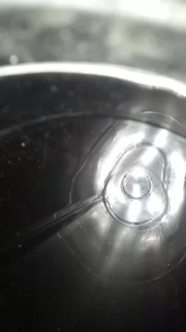

I got that problem solved with some small sheet metal screws. I had another question (I know I have a lot). When looking up the chimney pipe from inside the house, I can see a small gap where the 2 pipes meet. Its where the pipe slides over the crimped seam of the other pipe. Is this normal or is it going to leak smoke from there?
Are you now talking about the connector pipe? Pictures would be very helpful here. We can't see what you are seeing.

See where the crimped seam goes under the pipe on top of it? There is a small gap that doesn't fit tightly against the other pipe. The picture isn't the best quality, but I think you can see what I mean.
Doesn't look serious but help me orient myself. Is this looking up the chimney pipe toward the cap?
If the pipe joints are square and not skewed then should be ok. What type chimney pipe is this?
Sounds good. I have only used DuraTech, double-wall. No experience with DuraPlus.
