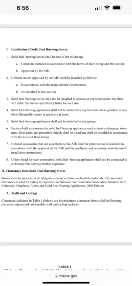

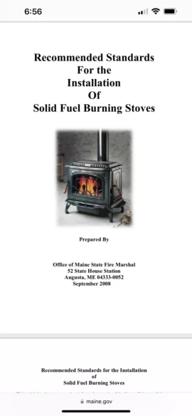

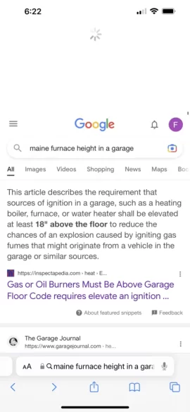

A furnace in a garage in Maine has to be minimum of 18” off the floor. If I recollect the code correctly.
In Canada they allow solid fuel burners if they are raised to 18" as well. Which I think makes sense. But I am not the one that writes the codes
