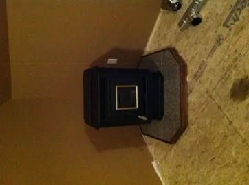

This duravent has the rope gaskets so I figured I would have to silicon the joints. Good to know about the heavy silicon. I picked up a small tube so maybe I will need another tube or pick up a regular caulking gun sized tube of high temp. Hope to have the trim onto the hearth pad tonight. Will then set things up and take some final measurements. Checked last night and I can get three feet and a little with the vent running inside before I go through the wall. Framing in the wall a little strange so have to lay things out carefully.
Was able to get the stove positioned tonight. Turns out due to sloped ceiling and some strange framing spacing in the wall I will need to go out and up. Going to sleep on it tonight but that is the current plan. [Hearth.com] Duravent vent kit
