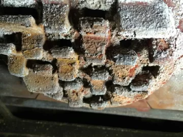

Hey everyone..I have been going through and replacing my gaskets today. Did the doors, now started the damper. The damper gasket goes across the inner top web. After I removed the inner top web piece to clean out the old cement I tried to put it back in place and it won't fit on the right side. I'm not sure if it warped or anything but it doesn't look right as it is. I posted a picture to show. I also have a picture of my inner baffle to see if you think it needs to be replaced. Should I just buy new ones of each?

This is what a new baffle looks like, are the air holes plugged on your yours? If so, a wire brush and small round file may clean yours up.

My professional opinion is : build a fire and stop worrying. When the stove won't run properly, or the damper won't open sand close properly, THEN start worrying. Cause you'll need a new inner top and all the other stuff in thee. Just enjoy the stove for now, and dream of the next one you'll buy someday when your 2461 wears out.

I was gonna give the same advice! If it's working, and not over-firing or running away, I wouldn't worry too much about it.
Thanks guys..Yea Matt it's definitely frustrating. I noticed on mine that the opening of the damper home is slightly warped so wondering if I should even bother buying the new inner top web. I should have just the old gasket alone!
Ours was warped too, like I say the previous owner abused and neglected it pretty badly. I would run it if you can, and wait until the burning season is over to fix it. These stoves are like working on an old house or car, fix one problem and 10 more pop up! Looks like you're not too far from me, so usually March/April is when "shoulder" season happens; take it apart then, re-do the gaskets, adjust the damper, check the cat, etc...

If what your concerned about is the web fitting flush take it to a grinding wheel and grind the bottom until it slips back in place, My 2460 has been burning 4 seasons now with this cheap fix.

A little better, but I had to grind it down a little.
My browser didn't refresh in time. The latest one I ground over 1/8 of an inch, and it still wouldn't fit. The rest of the stove is in such bad shape i'm not going to bother!

Your stove has smaller gaps at the web than mine does. I'd clean the cat, put it all back together and see how it runs.
