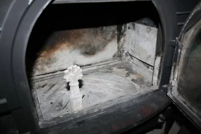

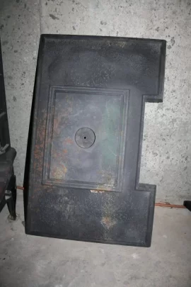

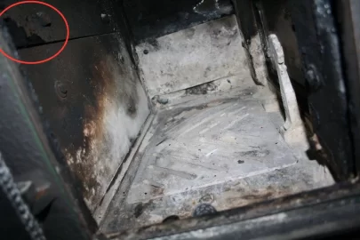

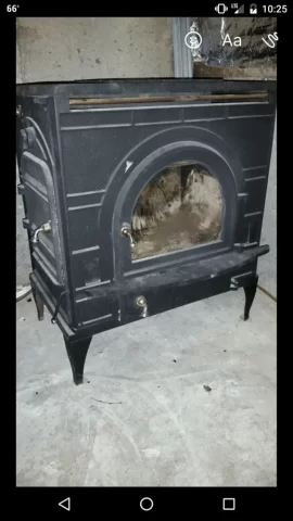

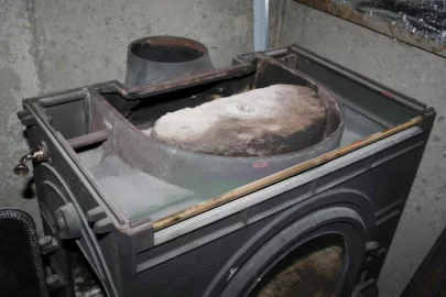

There is a DutchWest 2461 for sale super cheap near me. It needs a new top plate ($166). I am considering it. I am attaching photos. What else should I be looking for as problem areas? thanks for the help.

Not sure but this looks like a 'neverburn' model. If so, it has a history of being a cranky stove that needs frequent replacement of the refractory parts. And then there is this warning sign. I'd walk away from this stove, quickly, even if it was for free.

I noticed that too. I haven't seen in person yet but they say that is just the lighting and blackening, that it isn't missing metal.
OK, if it's just carbon then that is good. I did some more digging and see that I was wrong, this appears to be a catalytic model. The owner should be able to supply the model number from the rear UL plate. The top plate is easy to take on and off for servicing. It is held on by four corner bolts just under the top plate overhang.
If the cat needs replacing figure about $150 additional. Check out the damper operation to be sure it works smoothly and check the baffle below the cat to affirm it is not burned out. Inspect overall for any cracks. At this age the stove might also need gasket replacement on the door and glass.

It's not uncommon to see these on CL for about that price. Many will probably need the cat, but not the top. Is the top plate warped? If so, that would be a sign of overfiring that might mean potential problems for other components. The refractory that surrounds the cat looks a little toasty, too.

re: top plate. It is quite easy to replace - just a few exterior screws.

As for the top plate needing replaced, are they saying why it needs replaced? It would have to be pretty severely warped to not make a seal, and its only purpose is really to make a seal above the catalyst chamber. The refractory has some soot on it, that can be brushed off. The gaskets that I have seen in the pics so far look fine, and you can get a steel combustor for well under $100 for that model I believe. So really, that is a great deal. If you weren't so far from me I would buy the thing just to refurb it and sell it for $1000. I'm not sure what the market is like near you, but wood stoves fetch a pretty penny out here.

Kinda late to add a reply, but I have a 2461 that needs a new top plate due to warping, and the top plate is cemented in, so is virtually impossible to replace w/o cracking other parts.
