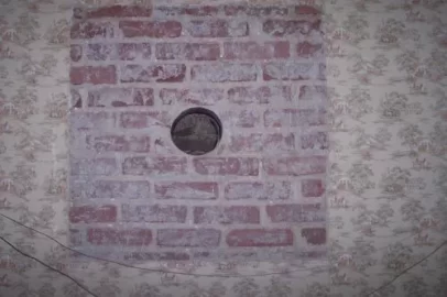

I'm not sure the wall thimble is what I need. What I have is an older brick chimney covered with mortar. I was told was that the wallpaper/paint on the mortar was "combustible". I know it is mortar all the way to the brick because I have chipped away 12" around the location of the new thimble. I will have to remove a couple of brick to get the dura-liner oval tee to fit into the old chimney. When I replace the brick, I intend to install a terracotta thimble where the current metal one is now. I also intend to build a wall shield out of 1/2 inch durock covered with 1/4 inch tile one inch out from the wall using the CB198 plans from the USG site. I want the terracotta thimble to be flush with the wall shield. There will not be any combustible material within 12"of the thimble.
As to the 12" collapsed, there are no moving pieces on the 12" adjustable pipe. It is one solid piece. As near as I can tell, it is just supposed to be "slid up" on a piece of non-adjustable pipe.
