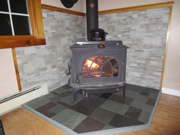

Not a very big hearth pad in terms of height. Plywood, durock and then slate tile (mainly since I had a bunch given to me years ago free of charge and only had to buy one extra box.) Back of the hearth is interlocking tile that looks a bit like stacked stone.
Bear in mind that depending on your stove you may have a specific insulation (R-value) requirement . . . or it may just be ember protection.
Costs are really dependent on how fancy you make the hearth and what you use and what tools you may buy or rent. I've seen folks use scraps, stone from their property, tile to look like stone, stone and even full sized pieces of granite, soapstone or other material.
For the record we put in this engineered wood floor (wife wanted the look and feel of real wood minus the height and with the added stability of engineered wood) years ago when we moved out the mint julep green carpet in the living room.
