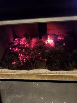

You're right for the falling logs on the glass using E/W method. And that is exactly why I made removable andirons for my Heritage stove. Super efficient and they help to get a full to the top load if wanted without the falling issue. The andirons don't change the original structure of the stove and cannot bend to the glass...if wanted for some reason, I can remove one or both andiron or the entire *kit*.

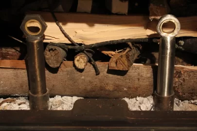

I always used sleepers in the Castine for cold starts. Hot restarts usually didn't need them unless the coals had burned down pretty far.
Short 1" splits or rounds that sit under the E/W load to allow air to get under the wood.
