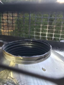

[Hearth.com] Early creosote with updated install- ss liner with wrap insulation, and with wood that is under 20%, I have been burning stove lower than I have in past. I have been cutting air back and, if I see secondaries, i leave it. Went to check top of liner today with flashlight and saw very thin shiny glaze on top inside of liner-appeared to extend about 6 inches or so. Vast majority of rest of inside of liner looked normal-with fluffy brown ask like soot. I called installer, who said that I should be burning a bit hotter. I described the paper thin thickness of the glaze and he said that, as long as I burn correctly going forward, that this is not a safety issue currently. He asked if I burned half a cord or less of wood-I said yes- less than half a cord. I wanted to see what you all thought given that shiny glaze creosote is not good
It looks fine to me, but I'm not a pro. I'm curious what is said as I'm in CT, and so far I've burned maybe a 1/4 of a cord (if that) so far. Been quite mild so far.
In cold climates it's common to get a little bit of glaze on the top bit of chimney and cap. If nothing is building up on the cap or on that screen I'd just keep burning and monitoring. After your overnight fire, have a good rip roaring hot fire first thing in the morning if you can.

If you see it collecting on the cap I would give it more air and burn hotter. and check your wood. Looks good right now

what I can see in the picture looks so thin as to be almost nothing. And if it's just in the very end of the liner as you mentioned I'd just monitor it at this point.
