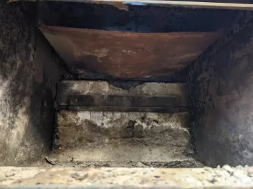

Hey there! I'm new to the wood stove scene. I recently purchased a used Earth Stove BV4000C and didn't realize what I was getting myself into. The catalytic baffle is warped and I'm going to have a new flat plate welded in.

I've attached a photo of the baffle inside the stove that is warped. It is pretty bad. It is warped at the rear where the damper is, as well as across the front where the cat inserts. I could probably get the cat to fit in the front, which isn't warped that badly. However, I am concerned that the damper won't seal off enough at the rear now.
I don't have the cat housing and will have to order the 3" version (the only one that I can find). I plan to modify the stops so that it can handle the 3". Do you happen to have the link to the metal cat you purchased? I was considering one, but I need the housing and I am unable to find that sold by itself (I am only able to find it in combination with the cat).
