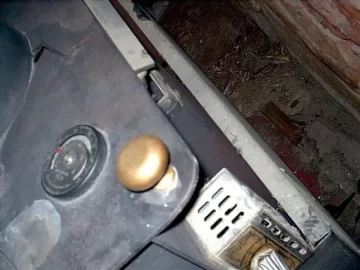

there should be an air control on it that has L M H it has a BI-metal coil in it and is controlled by how hot it gets, the pipe in the bottom is probably a fresh air intake an early version of an OAK (outside air kit). the 1 1/4" pipe going in to the chimney is so that when it is smoldering and the air is shut down it can still draw air to clear out the chimney so you get less creosote in theory. I had an Earth Stove before getting my Summit. It worked good but it did eat more than my new stove.
the air control looked like this on mine yours should have something similar.

on mine there was a flap that needed to be opened so it could draw air in to the fire it had a wire that held it open and you can see that wire in the 1st picture twords to top of the of picture.
you can see the flap in the second picture just above the air control knob.
